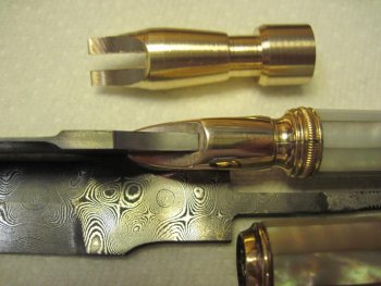

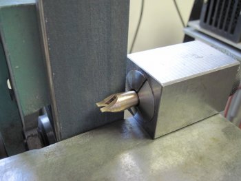

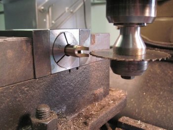

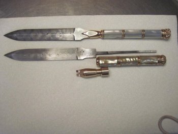

Before I start will tell you that I use a lathe and a mill with readouts to do this. I buy any good large old cutlery sets fore the mop or good stag, it is hard to get from the blade to a round handle. I just happen to be doing two now, these are old opera glasses sliding handles, they are mop and bronze. In this case using a piece of 1/2" bronze rod, the 1/2" will go in a collet so can turn in the lathe and use in the mill, turn the back od. first then turn it around in the collet and drill the center hole to where the back of the blade will stop, on the front end scribe a center line with your tool bit, this will give you a center to mill to when you put the radios on each side, I do the depth with the dro. cut the slot with a saw, you need the blade to the finished size or your slot will be to big, your tang will need to be the same thickness as the blade so it will slide threw the slot, I know you are going to tell me my tang is to small, but have taken mop handles off 12" carving knives that had 1/8" tangs that were 100 years old, I make them as large as I can never had one come back, this gives you a one piece bolster, it is a little hard to get the square end of the blade to fit the square in the bolster, use an air turbin to releve the inside of the bolster as much as possible may need to tap it a little and clean the slot with a graver. I also use the collet block as a grinding fixture on my Burr King disc sander and on my home made small wheel grinder, hope this is of some help, copy anything but my name.
