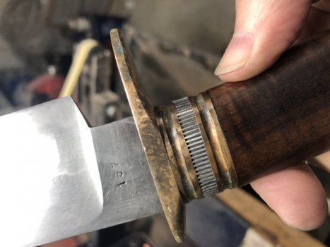

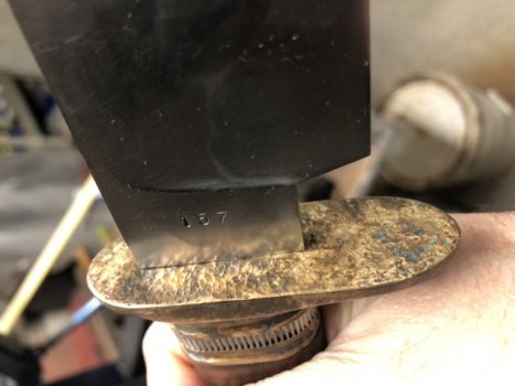

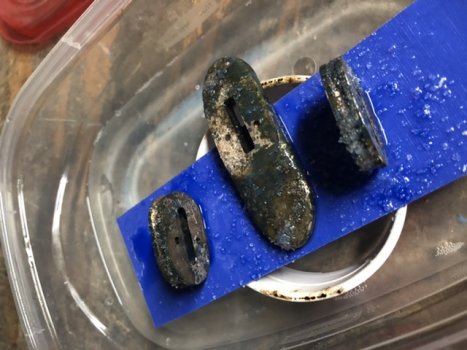

Worked on antiquing the fittings and guard. It took a nice patina. I’ll probably leave the steel spacer alone.

What process did you use? I just recently cold blued a brass bolster and I think it came out pretty good.
I basically fumigate it in a plastic container with ammonia. The pieces are suspended above the ammonia (in this case on a small G10 platform). I spray them with a little ammonia and sprinkle sea salt over them. Then watch and wait. Rinse and wipe off excess when the finish is where I want it. I plan to wax them too. There was originally more green on them, so I might try again see if I can keep it from completely wiping off.
