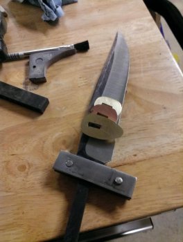

Here are the two on my bench now. The Koa hunter is getting the final spit shine. It has a 1095 blade, Koa grip with a inlet Aluminum bronze guard.
The big fighter is getting the handle fitted and then to the grinder.NCM_0189-2.jpg The fighter has a ironwood grip with copper fittings and a SS spacer.

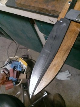

Working on the final grind after heat treat and fitting gaurd and spacers on this one.

I've been using a set of 1-2-3 blocks, and let me tell you- they make getting square shoulders a quantum leap easier, but there's enough slop in the bolt holes that I still end up re-dressing the shoulders a bit here and there as I dry fit the guards.
An actual file guide is on my list- as soon as somebody beats me into submission to make a knife with a full guard again. And believe me- the price of the file guide will be built into the price of the knife. I just finished 4 matching knives with full guards and I wanted to run out of the shop screaming with my hair on fire the whole time I was making them. There is a lot of truth to the saying "I could make a whole 'nother knife in the time it takes to make and fit a guard."

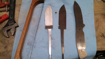

Next, I've been working a small batch of EDC utilities.
I have two of them basically finished (minus edge and sheath), but fear that one of the remaining blanks may be unsalvageable, and the other will have to go back to heat treat.
