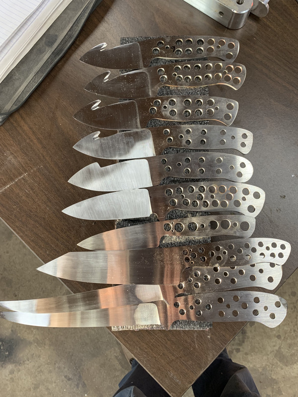

I've got another batch ready for everyone's favorite part, hand sanding.
I love these fillet knives after they are ground.
Hi Gene! They all look good but that filet is awesome! What steel is it and what thickness did you start with? I would really love to make something like that. I have several fishermen in the family. Might make them some for Christmas.

I make my fillet knives out of .060" AEB-L. They are a little tricky grinding, but after a few, well 20 - 30 for me, I've caught on to it.

Whew! That's thin. I think you probably grind bevels after heat treat but do you have any trouble with warping during heat treat being that thin?

I do grind after heat treat. AEB-L is known for warping, but I don't have too much trouble with it. I can usually get any warp out in the 2nd round of tempering. The fillet knives will warp during grinding. When they do, I just grind more on the outside of the warp until they are straight again.
