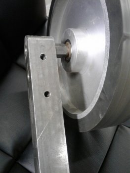

I thought about that, but I can’t tell if it’s domes or not.Just an observation. From the photos here it looks like there isn't much or any crown to the tracking wheel. Is that just a product of the picture?
I have seen people put tape on them to increase or add to the crown.
More crown could possibly help with the wandering while using the big wheel.
Hope this helps.
Scott
I did crush the first set of bearings. These are brand new and pro installed at a machine shop. I’m going to make some washers first thing in the am. I think that will make a difference too. I’m also going to try the tape on the tracking wheel trick also.You may have crushed the bearings some. I did the same, and made a washer out of .020 brass. It now as true as any tooling on my KMG.
I havent tried this, but just a thought...run a small bubble level from one side of the tracking wheel to the other. If it doesn't change probably no doming. If it does that should mean you have a bit of a dome.That should give you a rough idea whether it's crowned or not. (I think)I thought about that, but I can’t tell if it’s domes or not.
