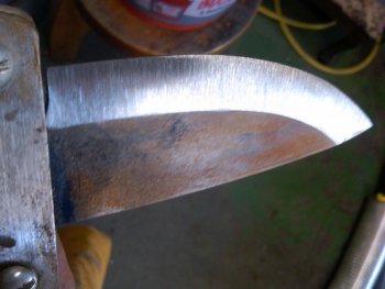

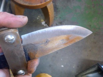

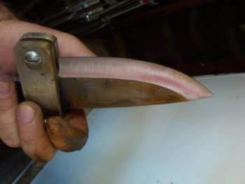

OK Dogs, I am working on my 3rd knife after destroying #2! I am interested in Scandi grinds but have a few questions. Is a Scandi grind typically a Flat grind or a Hollow grind? Can it be either? Any info you can give me concerning Scandi's would be appreciated!:D
Here are a couple of pictures, let me know if this qualifies.:confused:
Thanks dogs!

Thats the spirit:D. Its just practise,practise and then some practise when it comes to scandigrinding.
I dont know if there is a typical sort of scandigrind. The most common maybe is the flat one. Becouse the often use that for carvingknives. But there is both hollow and convex grinds. This is my opinion.
BTW the blade looks great.:D
Seved
The photos are definitely on the right track. Some of the production companies use 20 inch wheels. Those are technically hollow grinds but close enough to be flat. Either grind would work well.
Thanks Seved and Mike! This one is flat but I wasn't sure if people also did them hollow> I appreciate the info!
