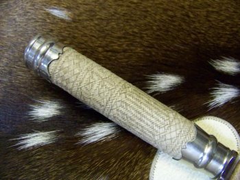

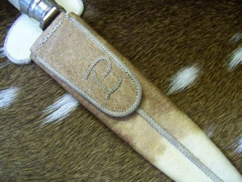

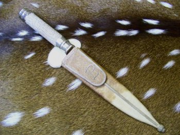

It is always a pleasure to see the the creation of my sheath and the braid work on the handle of the knife.
Pictured below is how it looks today. I just took it out of its display case a few moments ago for the photos below.
Horacio is a true artisan.
Paul
