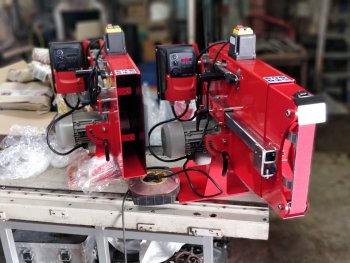

I can tell you the one thing that jumps out at me.
That is an absolute horrible place for the on/off switch. When something goes wrong you want the ability to hit the off switch and step aside in one motion! Firsts003 (1).JPG This is mine. Not to say I have the end all but, if I hear something I can step aside and slap the off button. It sits higher than start button and is easily contacted.
What I am trying to say. Is you may/may not have that warning. However when you do hear it you do not want to be reaching over the machine to hit the stop button when a belt breaks!!
