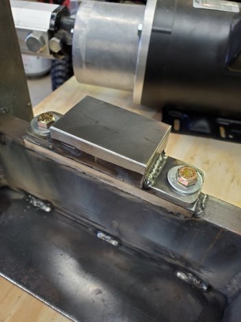

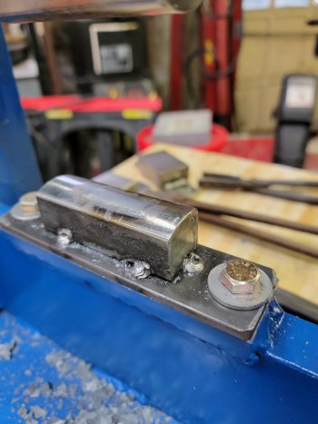

Ok so here are the set of Drawing dies and Flatter dies I made! I made the drawing dies on a 2" Diameter vs the Coals 1" Diameter. I tried the Coals 1" Diameter and thought they were too aggressive these are better but maybe even 3" would be ok?

Dies look really good. I agree the 2" drawing dies should work really good. The 1" Coal Iron drawing dies will really press - I need a kisser die to prevent squishing too much sometimes. I know you're looking forward to your first billet. BTW, your welds are looking good these days.

2 things I think im gonna do to press dies 1) Slot the die plates similar to Coal Iron and 2) Install studs in press, if I damage stud it will be easier to remove also was going to use nuts with captured washers in them so when changing dies I won't have to worry about washers falling down. I designed the press to be able to use the full stroke of the Cylinder. The flat dies just contact each other when I fully extend Cylinder. The dies are all 1/4" mount and 1" thick die. That way I can always have close to the same "SQUISH" no matter what die I have in it and it help with strength. It's a bit slower than Coal but again after using a CI I wanted it a bit slower.
