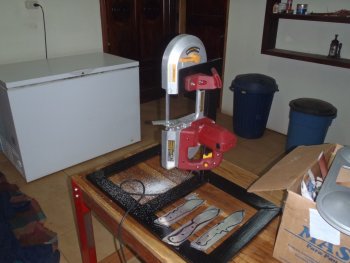

I have a HF and I made a little frame to use it like a mini vertical band saw. Ive cut A LOT of steel and Titanium with it and I ve have it 8 years +. THe switch went out but I just plug it in after I bypassed it.
I made one. I'd rather hack a bit with my 14" chop saw and let the belt grinder do the rest. Too damn slow.
I use it to make patterns from aluminum. Not much more.
