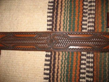

My latest try at stamping

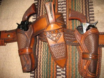

Not bad at all. Just keep practicing. Heres how it will turn out with a little more practice. KT
Hellgap, thats not bad at all, basket weave is one of the most difficult stamps to master and even then mistakes are a missed hit away.
KT, that is gorgeous! Almost looks like an inlay.
Kelly, Don't worry to much if your stamping isn't perfect. I'm always striving to get mine better.
Try getting the leather to it's pefect case and your stamp will be more krisp, the leather should brown slightly when stamped and the imprint will be more even. Also look for a good border stamp, it will clean up your borders and make your stamping more pro looking. Check stamping is all about moving your stamp a certain distance without changing angle and hitting it the same each time. The smaller the stamp the more diffecult it is to run. ( when it's strait in two directions like KT's, it shows your skill)
Lots of practice on scraps will get you in a rythem. RS
Hellgap dont worry you will do great. I have been doing this for about 6 years and all I can say is practice, practice , practice and all of a sudden you will be a lot better than me. I still practice with all types of stamps trying to get better. I,m 70 and will probably start getting worse.KT
Wow I woulda thought youd been carving and stamping 30 years Ill have to say you just have the natural tallent for this. I appreciate the kind words ya all kellyw

Nice work but I noticed the anvil be carfuly the iron will react with the leather like vinageroon dye does.
I find that basket weave stamping looks better when done on an angle vs horizontal/vertical. It's easier on the eyes and just seems to flow better. Laying down the starting line involves simply dividing the stamped area equally with an angled line and then starting on it working each side till you get the line done. Then filling in from there. When you get close to your edges, angle the stamp so it fades out towards the edge. Then, come back through with a camo stamp (looks like a sea shell). This will seperate your stamping from the rest of the sheath with a nice scalloped border.
Also, make sure the area to be stamped has been cut sufficiently with a swivel knife. This allows the leather to be stamped without stretching the face letting the stamped area sink down below the surface of the rest of the sheath.
Do you think I would benifit from buying one of those geometric grids to establish an angle pattern and straight. ???
