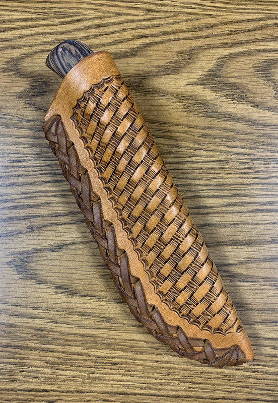

it seems no matter how straight I get even the first few lines I always have one or two spots that get wonky. Just need to slow down some I guess.
A few tips on basketweave.
1. Start in the middle and work both ways.
2. Use a good solid stamp. I broke a basketweave stamp right at the neck.
3. Finish the entire line before starting the next line. It helps to keep the lines straight.

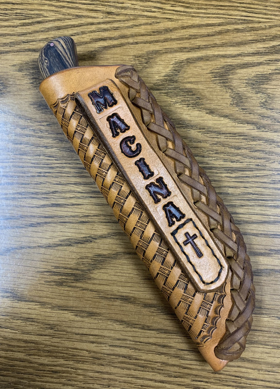

I have been extremely busy at work and in life. Finally found a bit of time to work on the sheath. Got it colored with Fiebings antique finish (tan). Also attached the belt loop. A little surprise for Daniel. If he loses it, now he has a better chance of it finding its way back home.
Nice package, Dennis. After seeing your last few sheaths, I think I need to start doing some edge braiding.

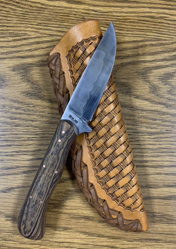

Here is a build along that I put together a while ago showing how to braid.
