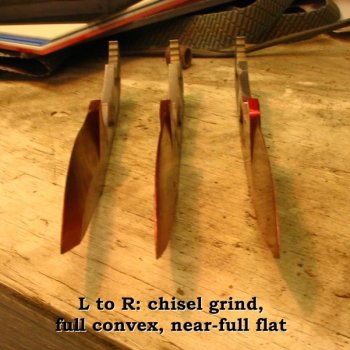

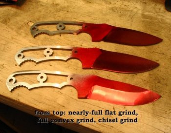

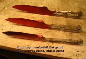

I thought it might be fun for everyone to show where they're at on this cool project. I'll start... everybody jump in any time, this isn't about "me"!
Yesterday I spent some time in the shop and got all three of my blanks beveled. As you can see the plunges and profiles still need to be cleaned up. I was feelin' kinda squirrely so I decided to make each one a little different... one with my usual nearly-full flat grind, one with a stout full-convex, and (drum roll please, this is a first for me)... a chisel grind.
I must say this steel grinds very nicely! It's clean as whistle, too. And the WJ-cut blanks are crisp and clean.:35:

Looking good James.
you jumped right into action !
Now I have to rethink my whole operation:les:.....you took all the nice grinds.:glare: I'll have to muddle through somehow:31:.
