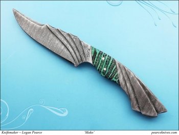

I just finished her this morning and I still have enough time to make it to church. :biggrin:
It's the second of my art knives that I call my Winged Series. I've been trying to teach myself how to carve metal and for me the easiest way is to used files and keep my lines as simple as possible, since I'm still trying to figure out how to do more complicated designs. The blade and handle are made from about 200 layers of 5160/1075 in a ladder pattern. The handle is coral. I was really hoping that I would be finished with this knife before the Arkansas show last month, but it looks like I finished it a little late. :p
I still have a long way to go, but I feel like I'm making progress.
Logan Pearce. ;)

lol, I don't think you are going backwards. :) Thank you! It took me about a week to carve the design from start to finish. Over all it took a few weeks for me to make it. The longest/hardest part was the carving though, which I feel a little embarrassed about, since the design is so simple. But I really like the way it came out, so the time involved doesn't really matter, I guess.

Logan,
When you're doing art work, time doesn't factor in so much as it does when you're on a deadline. Plus, the more you do, the faster you'll get. Did you use a Dremel or files? I know when I do my first carved blade, it will be mostly done with files, and cleaned up and polished with a Dremel. The handle work you did is awesome! Don't concern yourself with the complexity of the design, you concerned yourself with the most important part, and that's the execution of the design, clean lines, perfect depth, beautiful work! Looking forward to the day I can get to work on something like it!!! Rex
Rex, I used large hand files to take off most of the metal and give me a foundation for my design, then I go back with needle files and bend them as I cut. Depending on if the design is curved or not. Once I'm happy with the design, then I got back over it with sanding paper and get out all of my scratches like that. I tried using a Dremel when I first tried to carve, but I messed up more stuff than anything. I'm just not very good with it. The good thing about using the files is that usually if I get off track I can stop myself before it messes anything up. I agree, I should just be concerned more with how it comes out than how long it took me. I think its just that I'm not use to putting this much time into a knife, then when I do the knives seem to be a lot better. lol

I hope you recover from the surgery quickly. I spend a lot of my time sketching designs, even though I don't use most of them, because I'm not nearly skilled enough to pull off the designs I've drawn. It's a lot easier to draw it, than it is to make it. :p I'm definitely going to get the DVD by David, I like gathering all the information that I possibly can to make my work as good as possible.
I usually just get my needle files from Wal-Mart or Harbor Freight when there is a sell. I hear the Craftman is the same way about their tools. Which is great. I'll probably start doing that, since I run through a lot of files. Thank you for the information, it is really helpful. I'm really glad that my knife inspired you to do some of your own. I look forward to seeing it!
and here is a much better picture of the knife that I just got. It's a lot better looking than the one I took. :)

I draw all mine out in 2D. Usually I sketch out what I have in mind. It's usually pretty rough at first, then I refine it by sketching it over a few times and fixing the things I don't like. I normally just use black lines to mark where my cuts are going to be made. If it's a design that I don't plan on using for a while, I'll make small arrows pointing to the lines that I want to carve. I make sure to put the arrows pointing to the lines to remind me that is where I want the area to be relieved at. That way I can remember which part I want to be higher than the rest. Like on this knife, how I wanted to keep the middle wing on the handle higher than the two on either side of it. This is how I sketched it up:
I'm not great at drawing, but all I really use it for is just to remind myself of how I want it to look. Later I usually add color, once I have the lines where I want them. This is a different knife, its the first one I carved but this is what it looks like with color:
I usually keep two copies of the drawings. One with the bare minimum, lines and arrows only. Then the second colored so that I can see if it will look remotely similar to what I had in mind. That one ended up looking like this:
You can see how my design was changed a little bit, basically because I was limited to the handle material I had chosen for the knife. If I had picked a different material, then I could have got it closer to my design, but I really liked the coral, so I was okay with the change. At the moment those are the only two that I've carved. Once I have the metal that I want to carve, then I draw the same lines on the knife itself with a magic marker. I keep both the sketched designs of the knife that I'm working on in front of me while I file them down like I want. That is how I design them and everything. Not anything super awesome, but its been getting the job done so far. :p
