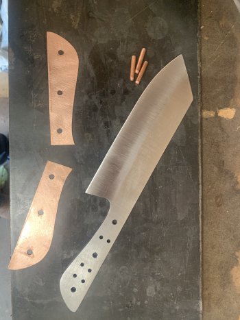

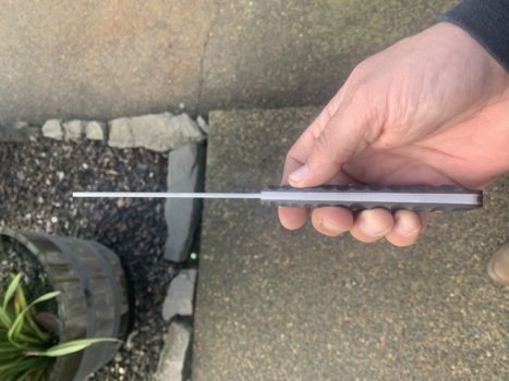

Some progress made on Austin’s KITH. I’ve decided the blade is going to be black, black G10 scales, copper liners and copper pins! I can’t wait to get it finished!

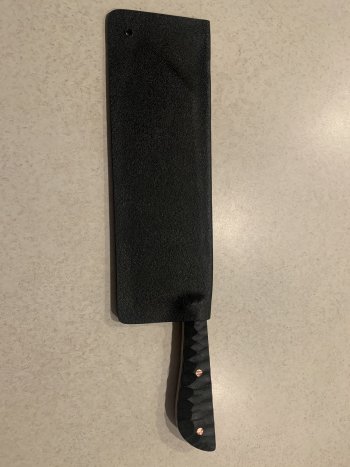

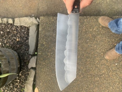

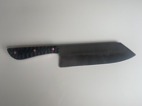

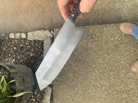

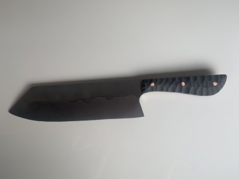

Well.... it’s done. This knife fought me the whole way. The copper liners and pins turned out to be easy to work with because it’s soft material. That was also what made it difficult to work with! The stuff gets hot, and FAST! I got my scales glued up and I let it all set for a couple days before I started working it again. When I started grinding the pins down my epoxy started boiling because the pins got so hot! Not something I anticipated! Oh well. Adapt and overcome! I’ll be honest, I’m not completely happy with the result but it is the best I could make it. Seemed like every time I would make a little mistake, I would make another mistake trying to chase the first one. It’s not as pretty cosmetically as I wanted it to be but I had to tell myself that I made it so it could be used! I can tel you the thing is damn sharp and will perform as I intended it to! Austin, I hope you like it and you cut through steaks, roasts, ribs, etc, with ease!

Bro! That looks super sweet! I am stoked to get this one in hand and use it!
