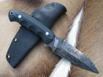

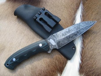

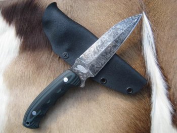

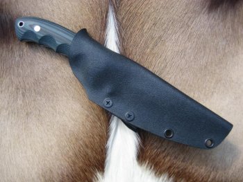

Built this as a an EDC for a customer who is a police officer. He wanted a high ride vertical carry to fit his gunbelt behind his service weapon.
1/4" thick 1095 with black/green G10 scales and my own kydex.
Thanks for looking.

nice. I had to study and think about the grind you put on that one. It makes good sense for the intended application. The fit and finish is or course flawless.
Were the notches fitted?

Good eye, Tracy.
I have a very scientific way to fit the fist notches. If I can get close to the new owner, I hold my hand flat against his, palm to palm, (not in a gay way) and eyeball it to fit my grip, bigger or smaller. I think for a tactical grip, the idea is not to drop it or let someone kick it out of your hand.
Thanks for the comments, guys.

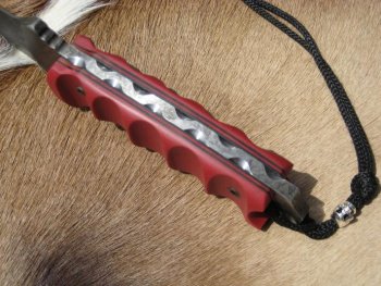

Here's some I did in red with black and red spacers.
I think that G10, G11, Micarta and phenolic are all kissin cousins. It machines very easily and holds up to any abuse. I finish it with GunOil or WD40 and you can touch it up anytime with a quick spritz. On some of my pieces I attach it with machine screws so it can be asily removed and cleaned up. I would not reccomend using it in combination with wood or Ivory bolsters as the WD 40 will penetrate the natural stuff and ruin it.
