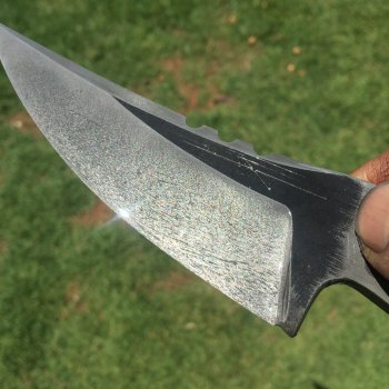

Can it in some way be used to disperse and reduce the size of the carbides? Like if you harden from that temp fully and then harden from a lower temp to reduce grain size... and get the right amount of carbon in solution... I mean if this pic below is the carbides in n690 and D2 then ithere must be some what to make it better... this after a few short FeCl applications....

Ah yes, I see what you mean that is some nasty alloy banding. Under the microscope you would see those lines as being large collections of primary spheroidal carbides. For this you could try a high hardening heat, immediately followed by a more reasonable one (cooling in between, of course). One could also play with isothermal spheroidal anneals that rely on DET, but you would then have fewer, but much larger spheroids, that would be selfish with their carbon.
Whaddaya mean my Stainless NieuWootz is nasty??!! ;-) :D
OK, so essentially I quench from 1080- 1100C - (1080C usually stipulated as the max aus temp) would tempering high to set up small tempering carbides be useful? and then use 1040 - 1050C and quench and LN and temper? I suppose don't quench fast enough to crack would be useful, a plate quench should be fine... would it be useful to extend the quench to make most martensite possible? I suppose RA would be of no issue during this phase...
I usually use 1060 (hunters)-1080 C(Kitchenknives) oil quench Liquid nitrogen and temper 150C, liquid nitrogen and temper 180C.
