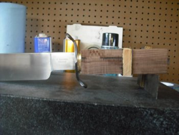

Thanks for the tips. Cutting it in half allowed me to drill all the way through on my press. I then used a file to connect the holes. Now I have a multi part handle with an osage center. Now I just have to make the end cap.

That going to look very nice.
