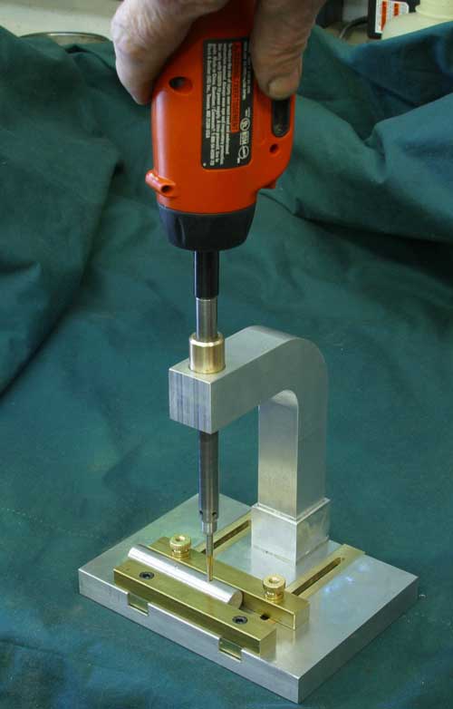

While we are on the subject, any recommendations on tapping thick titanium? I'm doing 2-56 holes and they are a booger!:eek:
I've drawn out a design for a hand tapper. It would hold the tap at as close to 90 degrees as I can get it.
I haven't made it yet, but would you like me to PM you my idea?
Thanks Stan. I have the catalog and was thinking about that. I guess I'm looking more for something I can make. I'm just begging for abuse.:beg:

http://www.finelinehair.com/home/hand_tapper.htm
http://littlemachineshop.com/products/product_view.php?view=classic&ProductID=2898
Great Idea. But I was thinking about a small tapmatic head on a small drill press. I seen the heads on Ebay for less than 100.00. Any thoughts?

I was told by a couple of people that if you tapping 1/8 thick or thicker Ti that the ends of both holes should be chamfered. The other thing you can do is use thread forming taps instead of thread cutting taps. And last, take a slightly larger drill and open up 1/2 of the hole so your tapping less material. So if your tapping .125 TI drill down .050 or so with a larger drill so your only tapping .075.
