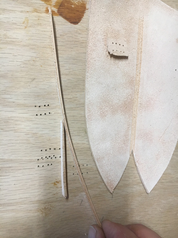

I got started on the sheath last night. I’ve made close to 20 of these knives, so I have a template for the sheath that I cut around.
Next, I mark a center line on the inside of the sheath and v-groove it. I cut 3 grooves, one on each side of the line and then one in the middle. I think this helps the sheath to fold better.
The next step is the prepping for the stitching of the belt strap. I groove for stitching, drill the holes with a 1/16” bit and fold it to the sheath and drill the holes in the body of the sheath.
After that, I cut a flap on the inside of the sheath where the stitching holes are. I will stitch under the flap then fold and glue the flap over the stitching to prevent the knife from cutting the stitches.

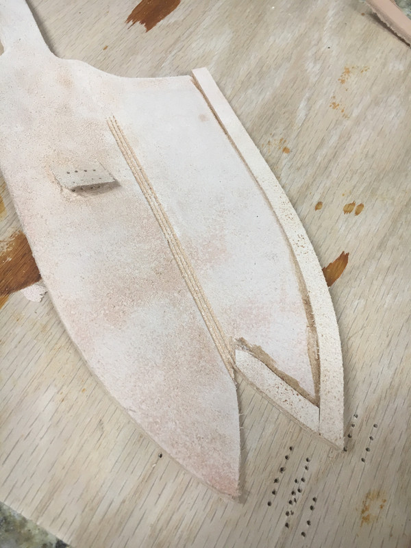

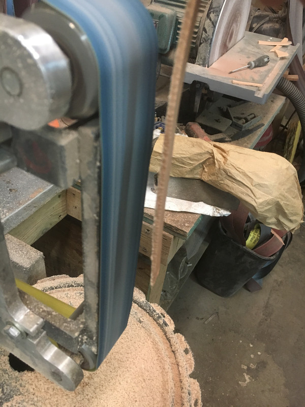

This one is almost done. I cut the welt for the sheath and tapered it on the sander. I do this so the welt has the same taper as the blade and the sheath fits better.
The welts are glued in place with contact cement.

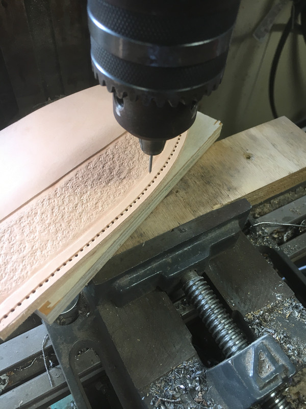

Next, I drill the stitching holes on the mini mill. I use a 1/16" drill bit reversed, that I sharpened the shank of.

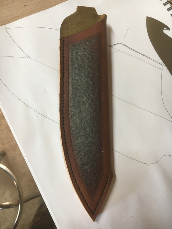

After staining the sheath, I stitch the loop down and glue the flap over the stitching.
Here it is after stitching.
And after sanding the edges on the sander.

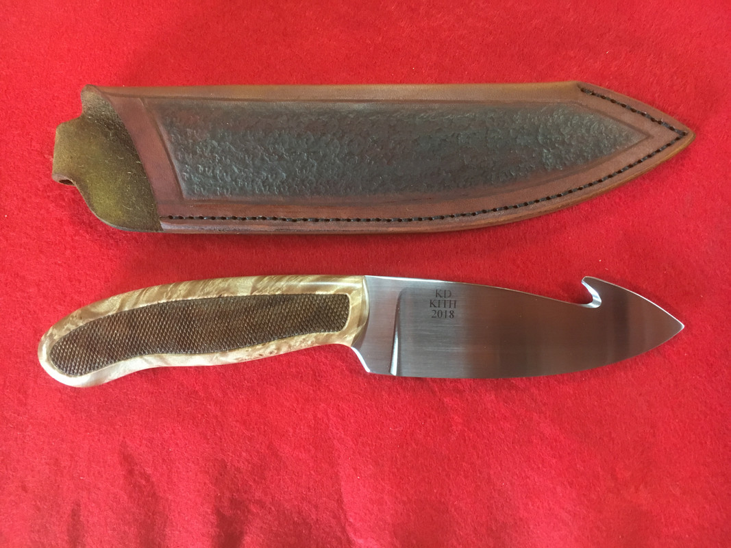

On to forming the sheath. First, I wrap the knife in plastic and wet the sheath in hot water. I insert the knife and form the sheath to it. After a few minutes, I'll remove the knife and make sure it is dry. Now the sheath needs to dry. I usually wait 2 - 3 days with the sheath in front of a fan before I put a finish on the sheath.

Not only is your knife a work of art, but the sheath is most excellent. You can really see that it is a matched set.
