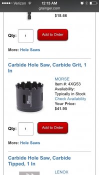

I use a bi-metal 1" hole saw with some cutting fluid on slow speed. If necessary, I clean it up with a dremel, but a dowel rod with some sand paper would work too.
Well I tried a step bit /unibit tonight. It worked great on some 5/32" 440c until I got to about 3/4" and then the bit lost it's edge I didn't have cutting fluid but I was liberally spraying some Break Free CLP oil. Still burned up the bit on my slowest setting. Guess I will try a carbide 1" hole saw.
I use a champion carbide 1 inch hole cutter. I think I get them at wholsale tool they work great and last for about 50 holes or so.
