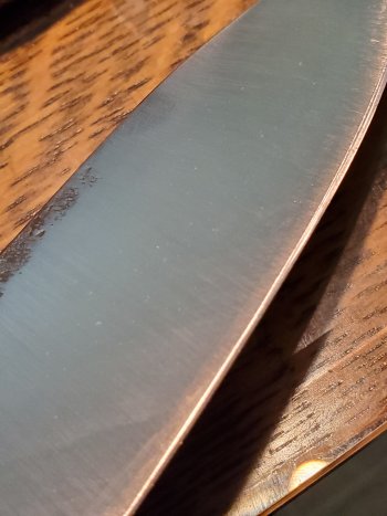

I'm sure the rotary platen is the way to go but I'm on a serious budget. Lost job due to Covid so the knife sales have been helping making ends meet. I used the felt at the class I took and it worked GREAT blending in the convex grind on my Chopper (please note this is not my regular finish).
