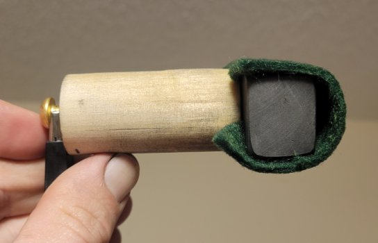

If the felt pad is removeable, you may be able to wash it out? Also, the etchant is a salty solution, so the pad may be crusty or the pad may be crusty on the contact point on the wand. I regularly use scotchbrite on my graphite block and rinse or change out my felt pad on my homemade etcher wand. If it doesn't etch or darken well, it's usually because the contact pieces (felt and conducter of the wand) need cleaning. Regular Crafting felt works well.
MTBob
Thanks, that's really good advice! Much appreciated.
