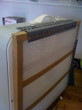

I have 3 of those in my shop! I bought some aluminum angle iron (is that right?) and attached it to the sides of my fans to make a slot I can slide my filters into on the draw side of the fan. It saves me a ton on duct tape and change outs are a breeze!
Keeping with the No Weld theme, I picked up some parts today
and made a No Weld Air Cleaner.

Simply Awesome. Great idea!
Think you started something here Boss.
Maybe a "Best Fan Idea" contest? You are in the lead as far as I can tell!
Dozier
ps. nice mod by Mr. Keith too

even better. I am converting mine next time I find some of that angle bracket shelving post..
The furnace filter approach will take out the visible dust making the shop air look much cleaner and is great idea. but most of dust is much smaller than 5 microns and will go right through the filter. The body has a problem getting rid of dust smaller than 2.5 microns. This topic has been discussed in great detail in several woodworking forums.
