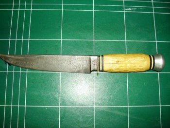

I have come in possession of a Carl Schlieper knife that needs some TLC.
From what I could gather on the internet, these knifes were mass produced and were sold en masse.
See the photo:

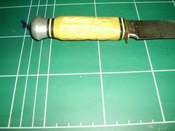

The design seems based on a Bowie with a false double edge. Overall length of the knife is about 250mm or 10 inches, with the blade being about 150mm (6 inches) and the handle 100mm or 4 inches. It has stamp on the one side of the ricasso that looks like a fanned out feeler gauge and the words "Carl Schlieper Solingen Germany" stamped on the other side. Steel is obviously a carbon steel of sorts. The tang is through the handle material and has a brass nut that screws onto the tang. Brass nut is sunk into the bolster. Front bolster is a brass plate, handle material seems to be stag or other horn with black & white spacers fore & aft. Handle is worn, but still fully functional.
![IMGP1767.JPG IMGP1767.JPG](https://knifedogs.com/data/attachments/40/40799-e18b169514b3752ba27b8aeff37b8c4a.jpg)
The quality of workmanship is not great, but the steel seems fine and holds a good edge. The blade is coarsely finished with grind marks clearly showing.

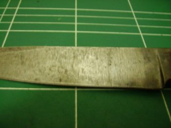

The knife blade was quite rusted, but it cleaned up beautifully by inserting the blade in vinegar overnight and scrubbing all the crud off the next day. No serious pitting is evident.
The truely sad part of this story is that the tip of the blade is broken off and was done by nobody else but "mwoa" in an effort to straighten it. Bad move!

The knife still has much potential, so I thought of refurbishing the knife and do a few alterations to beautify it a but, or "dignify" it, is more my chain of thought. It is not a major collectors item, so I would not be damaging its monetary value in any way.
