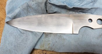

FINISHED!!!!!!!!! This has been the most frustrating but most fun build I have ever done. I believe it definitely pushed me to the limit of my current abilities. I was hesitant to sign up, but I am so glad I did. Chris, I hope you are happy with your knife. I humbly request that you be brutally honest to the smallest detail! That's the only way I am going to learn. And post them for all to see. Someone else may have the same issue. (I will enclose a note along with the knife that points out some questions I have in regards to the blade.) I appreciate everyone's comments and suggestions!! So glad I joined this group.

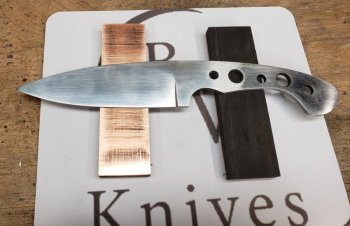

*Don't forget to compensate for the weight of the copper liners
*When using metal liners, grind a fuller to allow for epoxy to hold. (the liner didn't hold to the scales, had to re-do)
*Copper liners do not attach to the scale like G-10. Requires much more prep and caution
*Copper gets hot really quick, a fast dip doesn't work
*Roughing the entire metal liner leaves visible marks when against the handles.
