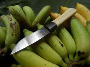

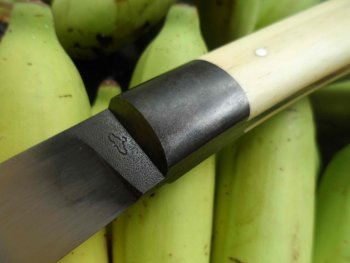

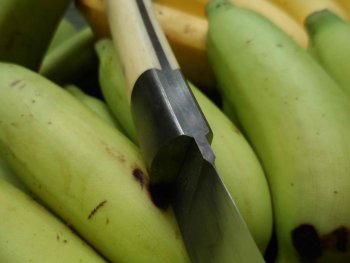

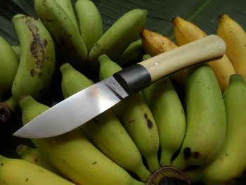

Banana Short Knife
Jeremiah Rostig
O7, iron, bone, sterling, water buffalo leather and bananas...:steve:
Blade length 85 mm, Overall length 195 mm...

Jeremiah,
Here is the US we generally call a skinner with the edge on the other side a Banana knife.
Of course your Banana's in Thailand are shaped different than most of the Central American Bananas we get here!
I bet you never realized how much Banana talk your fine looking knife would cause? LOL:lol:

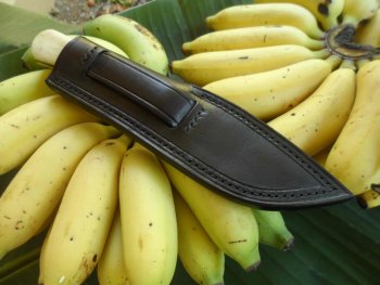

Beautiful knife and sheath Jeremiah. That O7 is some hard steel to pound. You've done it well, and the patina is nice and dark like I like um. That's a nice touch with the belt loop there. Fit and finish excellent.
Martin, I could be wrong, but I don't think Jeremiah forges the 07.
Beautiful knife, with great geometry and "neo-tribal" type styling, at any rate.
Thanks for posting it here Jeremiah. :)
