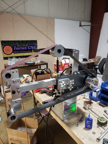

Hi. I'm a bit late to this discussion but figured I'd chime in. I own Torus CNC and have a couple 2x72 grinder models to choose from. I make them in Illinois. I've been selling them for the past 2 years so don't have a wide audience yet. The VERT is my more budget friendly option and is a vertical only; Unless you fabricate a tilting table top to mount to. The M-90 is my tilting 2x72. The VERT frame with flat platen and 4in drive wheel starts at $399 plus shipping The M-90 frame with flat platen and 4in drive wheel starts at $695. I have package deals as well. I'm new to the the forums so I hope I haven't violated the rules by providing this info. Anyway. Thanks for checking out my shop if you choose to do so. I have them listed on eBay, Etsy and my website toruscnc.com
Rich
