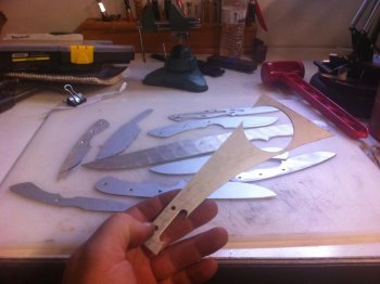

My answer isn't exactly one of those, but make mine out of thin aluminum. I got a few pieces of 0.075" thick out of some scrap control boxes and it works great. I was using wood before this and I like the metal patterns much better.
