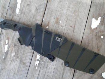

I have a bit of experience in this area, through allot of trial and error I found a paint that when properly applied was very durable.
It is a spray paint though so it won't help with the issue of the hobby spray gun.
The paint is Krylon Fusion, it bonds to plastics on a molecular level.
The sheath below is my Tiger/Zebra stripe pattern using the above mentioned paint.

I used Krylon Fusion when refinishing the composite/plastic stock on my deer rifle. The key is plenty of prep. I also used a matte clear for plastics and did several coats to ensure color safety. This was my first camo job. I took stencil frisket and cut my own shapes then painted in layers. I've had the gun out hunting multiple times since then, in rough areas and have had no paint scratches. Just remembered I used some Rustoleum paint as well, it bonds quite well to plastics.
another vote for Krylon Fusion spray paint. It is made exactly for this kind of application and it's pretty durable stuff.
