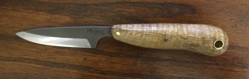

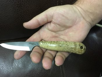

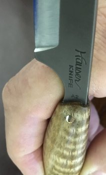

I like Garry's knives. I decided to do my version of what makes his knives appealing to me...simple clean lines...simple clean finish...super functional. I haven't done the sheath yet. This knife is for me! LOL...as in Merry Christmas Ted!! This is a little bigger handle than I make on these blades... freehand sanded on the belt grinder. Not perfect but it feels good in the hand.
Blade: A2 tool steel
handle: Stabilized Hawaiian Mango
finish on handle: coats super glue...sand 600 grit, polish.
Brass pins, brass lanyard hole.
Blade is etched in vinegar/marks browning solution 50/50% then hollow ground.

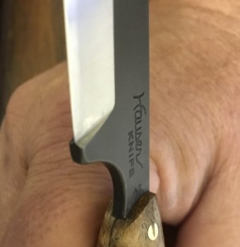

I do like the hidden tang treatment you have done with this one. It is a something I intentd to try at some stage with some of the swamp kauri I got recently.
