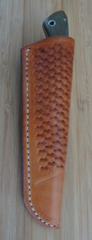

I can keep it straight for the most part but it does tend to run off. I've even put a red magic marker spot on the leading edge to make sure I keep it aligned straight. I almost made it on this one.
Here one I recently did.
