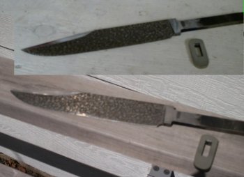

There's one on my bench that's crying out for a similar treatment. I refinished the blade and have a new nickel-silver guard fitted to it but haven't made up my mind as to handle material.

I'll try to get a decent pic and show you what I meant by refinishing mine... I think your Scoth-Brite idea would be cool as well.
Well I can't decide which pic is worse so I put them together. Basic hand-satin finish with a few drops of mustard applied to the flats. Hides scratches :D
That finish is very interesting! I think it would look sharp with a NS or polished stainless guard. Perhaps some African Blackwood for the handle?
