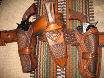

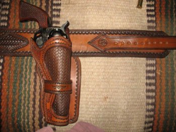

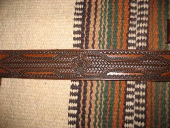

Before damping the leather put duct tape or masking tape one the back side. When done stamping let set over nite till dry then fold and this will take care of your problem. Remove tape next day before folding. KT
ok I asked this same question a while back with the reply it is going to happen. I am glad there is an answer I will try this as well.
It should turn out like this. KT
