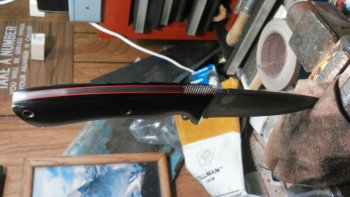

Here are a couple pictures of the jimping that I have finished. I use the Jantz tool with 20 lines per inch. You are only limited by your own imagination.
I like to do the same thing. Here is one done with a 20 tpi from Brownells.
