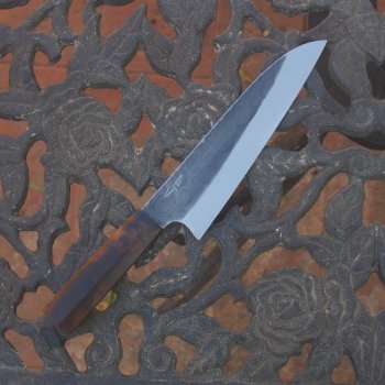

Yep, my favourite is a utility I made. 1/16" 15N20, 6" long flat grind Kitchen utility 2.jpgand still sharp after MUCH use. Cuts through everything you just listed :)

Honestly, no you do not need a full flat grind, but this was my first one, and I felt like challenging myself to see if I could pull it off. Happy to say that I did!

symmetrical and slight convex on 2mm O1... 210mm santoku for a local chef. and an assymetrical grind for my own k-tip that is in progress...
