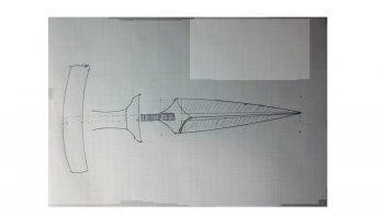

Secondly I'm trying to figure out how to attach the push dagger handles. I've attached a first concept drawing that I hope explains this a bit.
My thought is either to grind down about 1/2" from the end to create an extension to run a die over it. Or...use a piece of drill rod and wedge/pound then braze(?) the rod to the Damasteel and then run the die over the drill rod.
In either case I believe I would want to do that after heat - treat.
