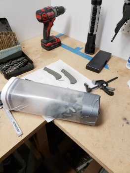

Here is what my tumbler looks like...yep it is just a container and I tumble by hand.
Here is what it looks like when done. I'm sure a real vibratory tumbler would work better but I think the finish looks pretty cool.
