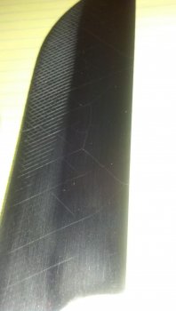

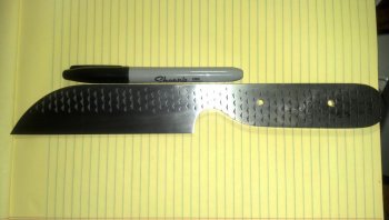

Well I'm still trying to figure everything out, but this one just ain't gonna make the grade.... Oh well it sure is good therapy :biggrin:. I didn't want to waste a god file so I used a cheap who knows were it came from one. I did like the way the Wharncliffe style blade turned out. The cracks really showed up when I got the hand sand down to 400. I pulled off and decided to use this one for a pattern. Looks like it's back to the grinder..........

The blade edge will be very hard and may chip if you twist and hack with it. I had good luck with these in a Draw cutting knife like the Sheepfoots / Warnie pattern you have made.

Thanks everyone, I heated it to non magnetic and then let it cool it the furnace for a couple of days. I noticed the cracks while I was grinding the blade profile, I think that they were already there or it happened when I was normalizing the file. Like I said it was a cheapo file I didn't want to waste a good one.
What should I have done different, if anything? Am I using the wrong normalizing technique to soften the file for grinding?
next time maybe bring the heath up slow after it gets non magetic put it in a can of ashes ive found some nickels used files at fle markets
I would believe the cracks were already there, but you didn't say just how you normalized. Annealing is not normalizing.
