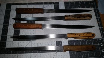

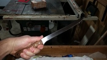

I'm using a variable speed 2x72 belt grinder. I made the initial edge bevel on a used 40 grit belt, and went to a 100, then 220. I read a thread here yesterday that spoke of the possibility of having formed a wire edge that was very hard, and that was just getting pushed back and forth, making the edge feel like it was not sharp, even though it is, just feeling dull due to the wire edge that won't go away. I'll be looking with my magnifiers if this happens again, but I'm not going to make any blades that hard in the future. Most of mine are 55/57 on the Rockwell C, at least that's what I shoot for. The knives I make are handled, then sharpened as the last step, so I can keep my fingers. I've always tempered knives I've clayed, being afraid that the edge would be not just hard and keep a sharp edge well, but would also be brittle. Here are a couple of poor quality photos of the fillet knives I'm talking about. Mike

OK, you're using a 2X72 - is it reversible? I run my 2X72 in reverse when sharpening. BUT - anyplace you can get the blade so the belt isn't cutting into the edge, but pulling away from edge. Once you get to 220, then try a 400 grit, then take an old worn out j-flex felt turned inside out so the back side is out, load it with green compound. That will take that wire edge off nicely.
