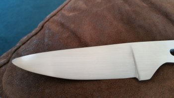

If it were me, before I started to hand sand all of those deep scratches would be removed on my grinder. Get a smooth uniform 220 or 320 finish before you break out the sand paper. I bet those in the top picture took a long time to come out by hand. the bottom p[icture is a great start there are a couple of leftover scratches on the tip and on the plunge lines which can be hard to clean up.
