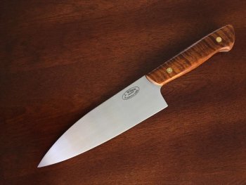

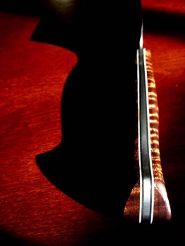

8 inch chef. AEBL stainless. 2 inches tall at the heel. .110 stock with a full distal taper making it right around 2mm at the spine above the heel. The last inch or so has flex if you lean on it but the blade feel stiff and predictable. (A flexible blade can take an immediate turn on you if you twist the knife at all when you cut.)
