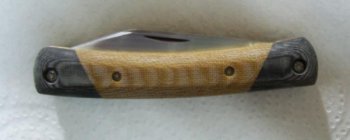

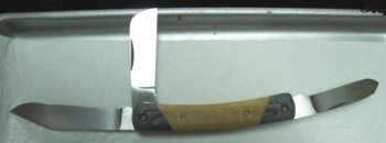

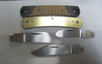

But my favorite pattern is the stockman so the beginnig of this year I decided to build my own. I noticed that some I have have two springs, some have three. Some have inner liners and some don't. So I did my own design and the spring/blade/position geometry can be a pain. I decided to use micarta and O1 for materials and I carry and use it every day and I love it.
