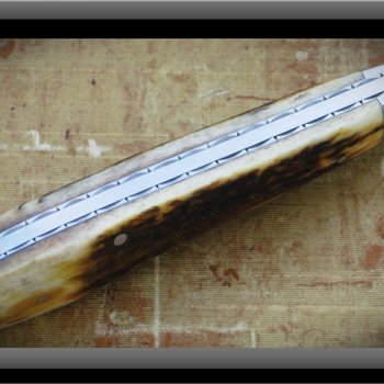

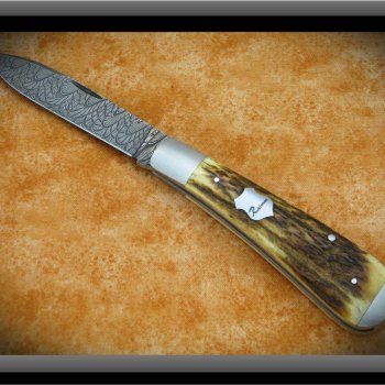

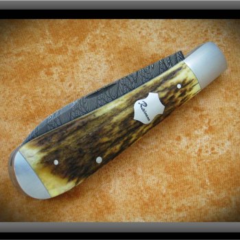

I finished this today and I'm real happy with the results.
4 3/8" long closed, 3 3/8" long blade of Mike Norris stainless damascus, red stag scales, integral bolsters, liners, caps of 416 stainless, Sandvik 14C28N for the spring, bronze pivot washers and stainless pins. I made the shield from .060" 416 stainless and etched my name on it instead of the blade like I usually do. This is about the fourth time I've done this filework pattern and it's getting easier each time.
Please tell me what you think.
Enjoy!

Calvin, that is absolutely top shelf work! I like the name on the shield!!! If you want someone to test that one for you let me know and I will come get it for a year's testing with published results at the end of the year! :D
All joking aside that is one anyone would be proud to carry!

Now not to take away from the reason we are here, that is one of the finest slippies I have seen in a while! I keep going back to the pics and the more I look the more I like!! Calvin you done yourself proud on that one!!!

Thank you all for your kind words. I mailed it off today for engraving. I'll show more photos when I get it back.
