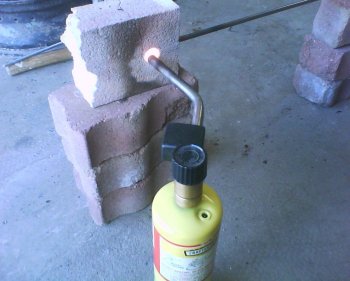

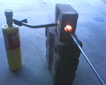

if you can find a thick firebrick, one of the really soft 3x5 bricks, (i cant exactly remember the dimensions of mine) you can actually drill a hole down the end of the brick and put a hole in the side for a torch, and it works as a small makeshift forge, it gets plenty hot for carbon steel, but i dont really work with stainless... ill try to find a picture of mine...
