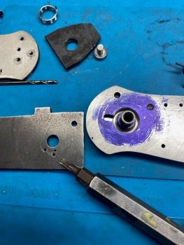

Most buttons on auto knives have a 5 degree or 7 degree ramp that under spring pressure pop up and hold a blade in the open or closed position.
Getting that button centered, especially on the open position is tough.
There are tapered end mills sold most everywhere that sells end mills in 5 and 7 degree tapers that will match your button.
Here is an example. This button has a flange. Some do, some don't. Looking at the top you will see the cup the little spring on the right fits in. Also on the cup end you can see the taper. This is the part that engages the blade. You need a taper in your blade to match this.
