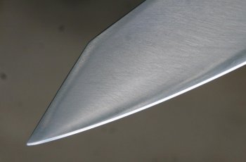

Hello, Im getting spots in my pics.. I use a cannon EOS 30D and have enjoyed the camera alot! Over the last few months I started to notice small dark spots in my photos.. I have cleaned the lense and there still there.. please explain how I would go ablout cleaning this or solving this problem.. Or do I have to send this in to cannon to get cleaned properly?
Here is a photo showing the SPOTS!!! Uggg..
Any advice or help would be greatly appreciated!

I am guessing that is dust inside the body on the sensor.

I have cleaned sensors before and there are kits to do it. Use google. Having Canon do it is really expensive. The sensor can scratch easily. Try a puff of canned air first. Even canned air is hard on the sensor but I do it about once a month when I am changing lenses often. Often you see the dust or lint and use a Qtip to remove it. Blow the loose fibers out of the Q tip first. Don't "scrub" the sensor with the q tip, that will scratch it.

Randy, when you remove the lens the sensor is straight back inside the camera body BUT its behind a mirror. The mirror reflects the light coming in through the lens up to the view finder. When you press the shutter button the curtains open and the mirror pivots out of the way exposing the lens to light coming in. There are a lot of tutorials and videos on your tube for cleaning. Ive been lucky and have always been able to get dust out with a little air. Another alternative, if your editing software is capable, is to fix the black spots in the software with cloning tools etc..

The spots are sensor dust marks...any dust on the glass elements will only blur the image to an almost neglible degree...
