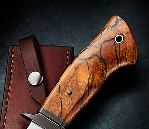

I think it goes both ways. For a fixed blade I usually start with 3/8". That give me room to shape and contour depending on what I am doing with the blades handle! I would have some to grind off, than to realize I don't have enough thickness to shape it like I want! Now if I do something like this Moran style handle I want to go even thicker to be able to flair that butt!
