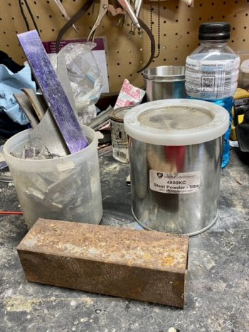

A large part of my upbringing was assisted by my Grandmother who was a survivor of the depression so I hate waste and tend to keep most of my larger HC drops and all of my damascus drops. They come in very handy if you make canister. You can use the HC drops for can ends and filler. Here I have my 1.75 x 1.75 can maybe .125 thick. Some powdered steel (USA KNIFEMAKER) and my tub O drops. Why do I use 1.75 x 1.75 cans? Because that is what I have right now. Simple.

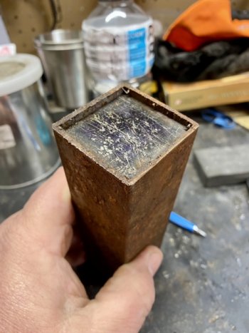

Chris Railey
If you notice I have the lid inside the can by maybe 1/8 or so. That was advice from Ed years ago. I have found it really does help keep the ends on the can for longer allowing me to be sure my welds set before I lose them and everything spills out before it welds. I will do the lid the same way when it is time.

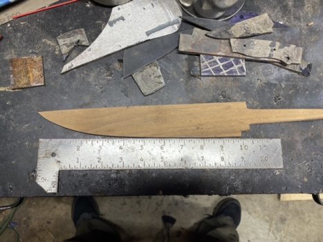

Chris Railey
Looking interesting. Got a drawing or sketch?
Only in my head John but its based on one you helped me reshape a couple of years ago. That has been my go to Bowie shape every since.
Actually I went digging and found this template based on the original I mentioned above. So something like this.

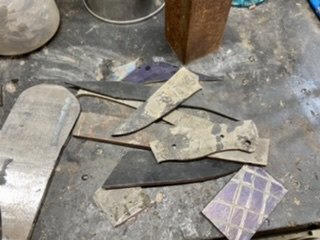

The bottom is welded on the can so time to work on the filling. Pick pieces which are easy to clean up on the grinder because they need to be clean to weld. In the picture you will see the two halves of a damascus knife I broke trying to straighten a small warp after temper. They make good can stuffing so don't throw them into the woods.

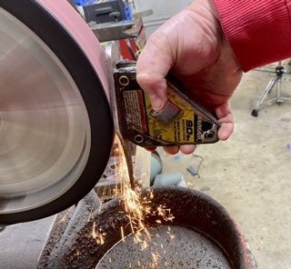

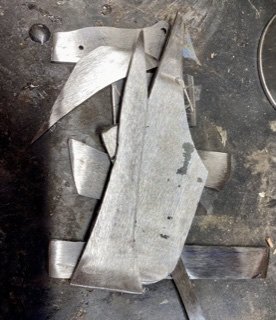

Chris Railey
This is pretty much what you want clean and shinny. I will use a dremel tool and a cone shaped stone to dig out that little bit of scale left in the deeper hammer marks. I really do not think it would matter much if I did not but I am too picky to leave it. Now, I will cut this stuff up to fit in my can. You can stack to try and control the pattern but I am way too ADD to think I am gonna remember what is inside the can after the oh, second heat. So random it is…
