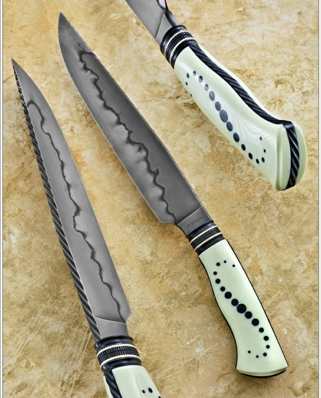

I would encourage you to look at work by Don Hanson, Jarrod Ball, Jan Hafinec, Mike Quesenberry, Nick Wheeler, Don Fogg, John White and Karl Andersen.
Every one of those guys understands hamon as well as anyone. And it shows in their blades.. And I can personally tell you every one of them will disagree with you on clay thickness AND placement. And if I compare the visible tangible results to yours......I know who I'm taking advice from.
As for the 36 grit rough grind for quenching...it absolutely CAN cause you problems. Maybe you've never got big visible cracks....but do you have micro cracks? Would you even know it if you did? Do you test your blades?
In addition to cracks, if your blades were highly polished and well finished (which they don't look like to me) I wouldn't be at all surprised to see "ghost scratches", remnant heat treat artifact, of those 36 grit scratches show up after post HT grind and clean up if the blade was well finished and etched/polished. Try it sometime....you may be surprised.

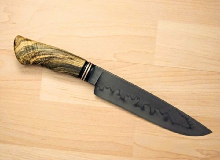

Perhaps you missed the "Quick and Easy" part. I am well aware of Don Hanson III, Nick Wheeler, etc.
First the quench at 36 grit part. Ever since I have access to 36 grit belts I have heat treated and quenched at that grit.
This was my ABS blade of 5160 that I used to pass the ABS Journeymans qualification back in 2001. 36 grit when quenched.
One of my five knives to get the Journey mans stamp back in 2001. 1084 with 36 grit when quenched.
Turkish Damascus blade. 36 grit when quenched.
1084 blade with 36 girt when quenched.
Cannister Damascus chain, 36 grit when quenched.
Cannister Damascus, chain, 36 grit when quenched.
Cannister Damascus quenched with 36 grit.
Pattern Welded Damascus again at 36 grit.
All the knives I have ever heat treated and it's been hundreds have had 36 grit. I feel justified in saying that at least for me, 36 grit doesn't cause any problem during heat treating.

Now for the Hamon part. I have found that if the clay is the same on both sides of the blade that the thickness of the clay doesn't matter. The hamon or temper line will follow the clay. As I think I already stated for what I sell my blades for I am not going to spend the time to get a Don Hanson III Hamon. I looked for a "Quick and Easy" way. I think I found it. I am sorry you don't like my knives but my customers do and that's what counts.
Thick clay
Thick clay
This is all I will have to say on this issue. If someone wants to ask a question as to how I did something I will try to reply.
I feel I have with pictures supported what I have said about 36 grit and clay.

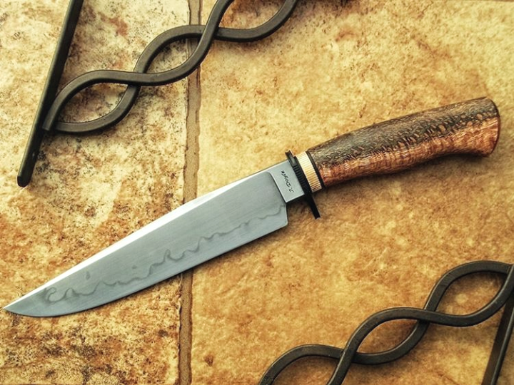

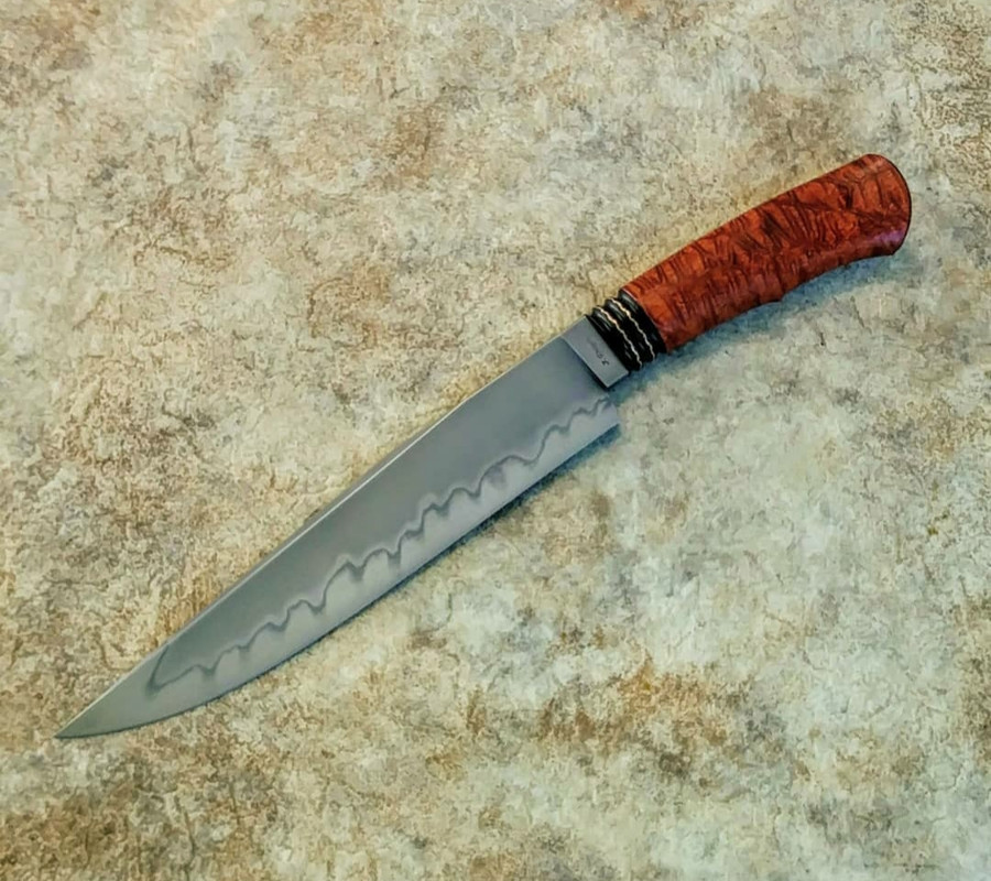

I didn't miss any part of your post....in fact I addressed that part and went further and told you exactly what my issue was.....which you didn't address. When someone else in this thread asked you about something, you questioned their experience level. When I question your experience level, based on your own post and words, you seem to get defensive........odd.
As for the 36 grit topic- you showed a bunch of pics of knives that you quenched at 36 grit.....good for you. Still didn't answer my question about if you test them or not or how do you know you don't have micro cracks.
And the hamon topic- you showed several pics of knives with some "meh" hamon and made sure you let me know you used thick clay. Imagine what they might have turned out like with thin clay. That part of the process has no bearing on "quick and easy" so it wouldn't hurt to try it huh?
But no matter. It seems you're pretty set in your ways and have all the knowledge and answers you need so carry on.

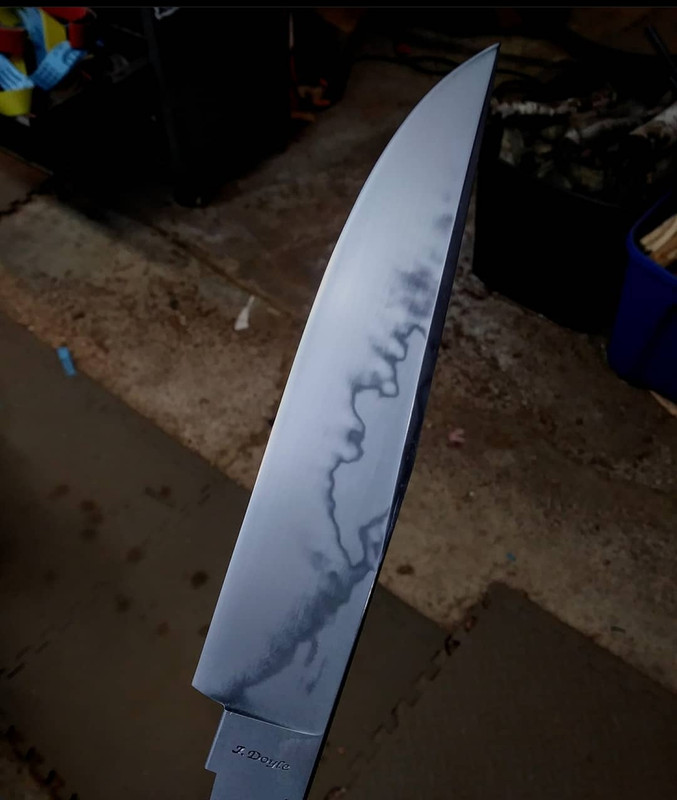

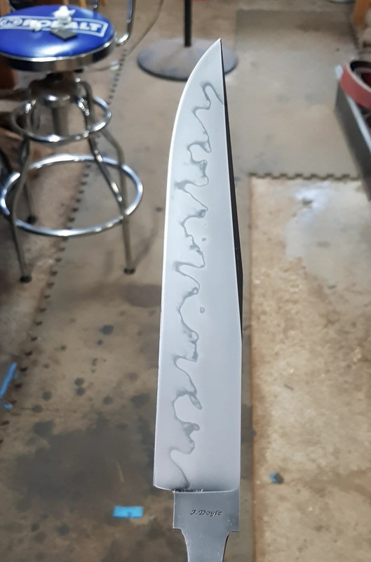

Really? My work is shown on here regularly....with clear detailed pictures. But I'll be sure to post some for you.
